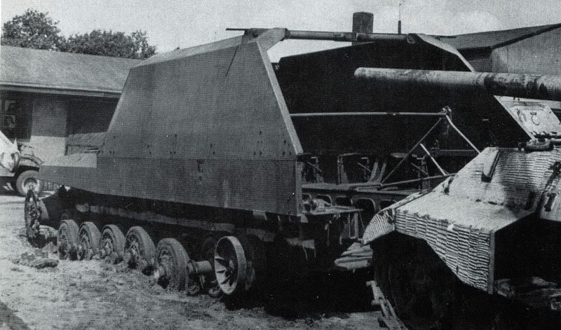

After an unknown period of time the vehicle was 'dragged' out of the shed and stored outside near other vehicles, allowing some interesting color references in the daylight.
An interesting shot as it is in broad daylight and has a nice comparison in tonal values to a dark yellow Hunting Tiger (which I would say has been outside a while and is definately faded to a lighter version.
A metal bar has been added along the top of the rear armour brace?? Wasn't there when it was inside the shed.
The interior has also been cleared out, so no opportunity to identify the junk that was in there before.
Another view from the front.
An interesting detail is the mounting plate for the drivers periscope - brand new obviously as it is a totally different tone to the front plate- could even be unpainted steel. Notice the white painted line along the chassis, probably to mark the position of torsion bar tolerance flex when fully loaded with gun and ammo etc.
The MG blister casting was original and not carried over from the KT according to my references. In 1943 the protoype work was authorised to commence and later was also directed to use carry over King Tiger parts as much as possible, which can be identified by the running gear as well as the engine deck fan covers and engine.
This vehicle is lacking the internal exhaust pipes and the external ones as well.
It has also not been fitted with the heavy duty bracing for the inner walls of the side armour, within the fighting compartment.
There are also two mounts for what seem to almost certainly be the travel lock and these appear to be in RED Primer.

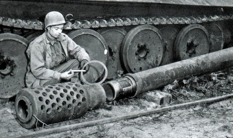

My next dilemma was the cradle and barrel, as I do not want to waste the detail these provide, let alone the fact that they are a large piece of the model. I decided to use some artistic license with the scene and depict the storage building with a damaged roof so that the interior of the building could be viewed and have the cradle and barrel just outside next to it (to show these as well). They were actually found outside but as far as the location goes, I do not know. See photos below. Could be close and looks to bewithin the same area.
Same muzzle brake as the E-1OO.
Some interesting tones to the cradle assembly ........as well as the opportunity to add some hand written chalk markings to the model.
