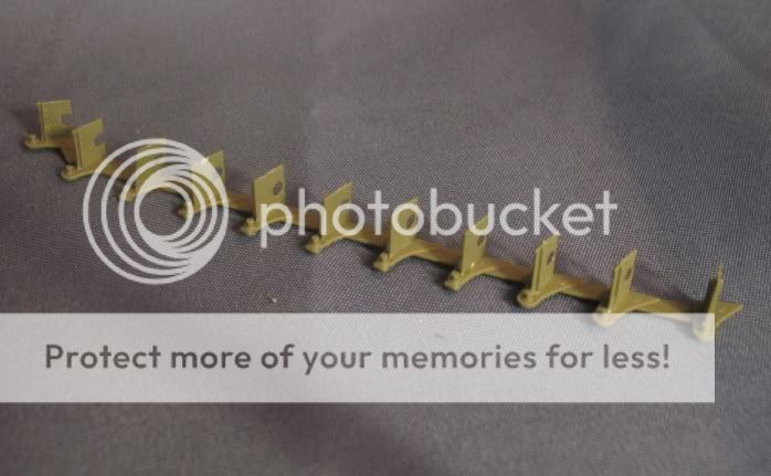

Firstly stick the panniers together with the springs in place like so:
Next take all the parts from the sprues and lay them out in order. This means they are all ready to hand, and you won't get the various types of similar looking parts mixed up
when that lot is ready, take the two parts that form one side of a suspension and stick them together, then stick on the supporting cross parts:
Wait till this is pretty set
Then take the two parts that for the other outer wall, and lining up the supporting cross parts, stick them on:
Now, leave this for a few hours to fully cure If you don't, things start to fall apart during the next stage and it all gets very frustrating!

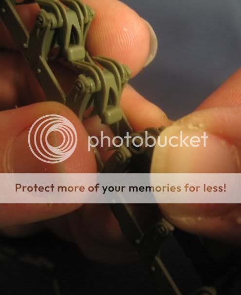

Once that has fully cured, you can insert the swing arms. This can be easily done, even with the rest set, as there is plenty of spring in the assembled parts. Simply take a swing arm popping it over a location pin on one side, then gently flex the other side until it 'pops' in:
You don't glue these in, once they're in place, the rest of the assembly holds it together
You end up with this:
Which can then be easily gued as one unit to the pannier:
