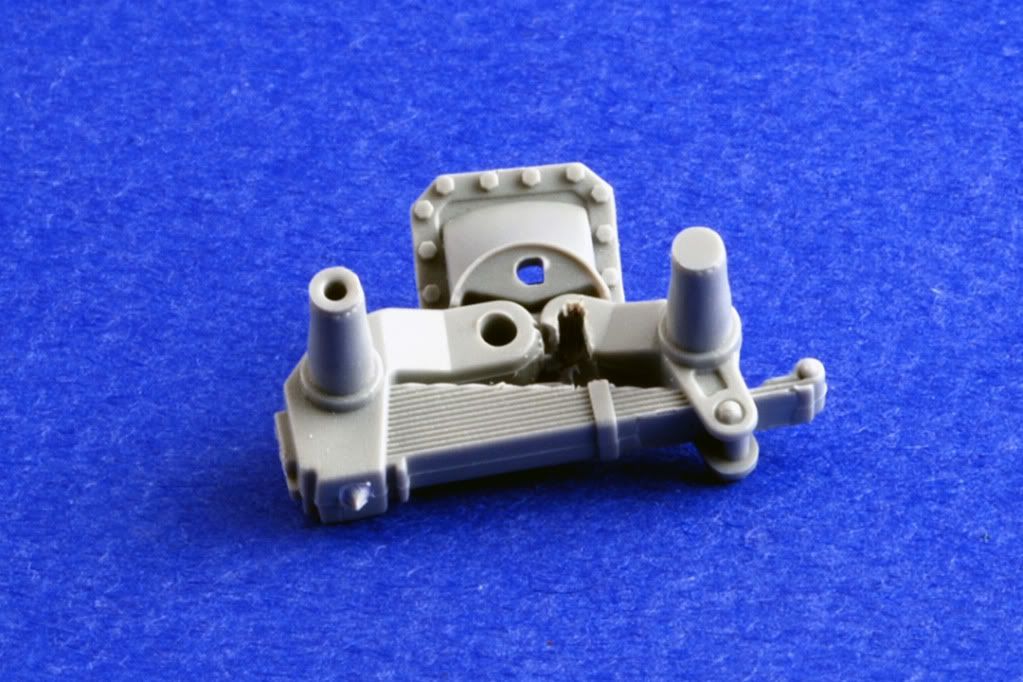

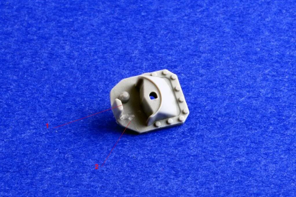

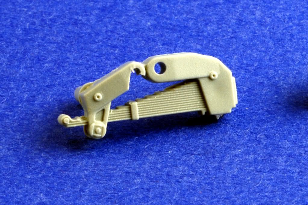

Few things to update guys.... First, I wanted to show how the suspension was modified to be workable since someone asked. It's very simple but hard to explain without pics so here goes.
First pic shows where the smaller of the rods that hold on the "arms" is removed (2) and then you have to trim off the top and a little of the side of the the bottom middle part (1) that otherwise will restrict the movement of the "arms" after you have it together. You just have to use trial and error to figure out exactly how much to file away but it's not a whole lot.
As for the "arms", just cut out where the small rod would have fit again to allow the "arms" to travel to each bumb stop.
That's pretty much it. Put it together and once the cover is put on, it sturdies up just like the older dml kits.
Granted it's not as accurate of a movement as say the Tristar kit would be if assembled properly where the spring can also move in and out of the rear shackle but hey, unless you make it super articulated, you couldn't tell anyway.
