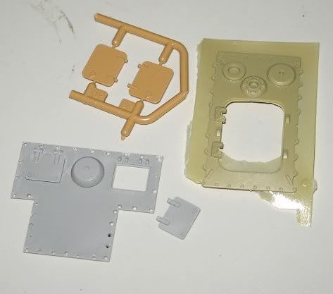

Ian, I thoroughly enjoy this type of modeling. Enough to break my silence. I hope this post is of some use.
This item may not be used on the vehicle. If it is, it will limit how far the hatches open.
The ventilator is actually smaller. By exchanging it, you then have room to replace the crew access hatches.
The kit crew access hatches look like Pz. IV types but are quite a bit smaller.
On my kit, I scrounged up some old Academy hatches from their ancient kit. Here are two photos for size comparison.
Since you seem to enjoy this type of cutting and replacing, I thought I'd mention this.
Now, to resume with my regularly scheduled lurking. I may be quiet now but still admiring everyone's work.
Saúl
Hello Saul,
thanks for breaking your silence,much appreciated.
I agree with your observations, as they make good sense with those access hatches and the ventilator. As the front cover is not shown in any photograph , it's up for grabs .........i took your advice and removed the ventilator and added a VP Resin ventilator base (it looks more like it is still being put together). Quite a nasty little part to sand off the key. The casting for the hatch cover was warped anyway so I cut it out and sanded it down.
I then went for 2 Tamiya MK4 J hatches I had spare - i added these in the same way they are used on a Mk4, rather than trying to cut 2 larger square holes and imbedding them - it would slow me down (and then I would get bored and probably stop, which is what I am trying to counteract).I also took out all the bolts . Some are a bit off mmmm I will have to fix.
