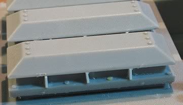

The Cradle
Well, here I am again and thank you all for the interest and reply's.
I am glad that you are getting something from this as I have nearly 'blown up' the camera I reckon with the amount of pictures. :lol:
The next shots are of the cradle that holds the gun. This was missing all of the inner detail and the outside detail was only so so. I replaced the front bar for the crank with an Auminium one - just because I wanted to I think.
DML give you all this brass for the kit and then the instructions leave you 'high and dry' and don't use hardly any of it. The really weird part was the PE for the cradle [copper in the pictures].
Gotta love those large injector pin marks.
As you can see above the PE had no elevation to the bolt heads. The marks were there but no substance ......and these are BIG bolt heads! So I went about putting them in. One thing I learned from a post on PA recently [can't remember who gave the tip] that I will use - hex shaped plastic strip stock for bolt heads, you bet! It's gotta be easier than the bloody punch and die set from Historex that seems to be changing from a hex to a circle with each use. :angry:
I also replaced the plastic rod on the side with a brass one, as it looked just a bit larger in diameter, which was what I was after. I then discovered the inner sides of the cradle should be covered in bolt detail as well [well of course!] and just staired at the thing in horror........this went on for quite some time before I moved on to the body and said ' I will do it later then!

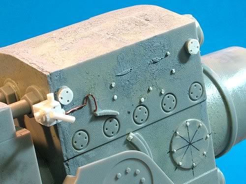

I also added the box on the side but I had to work off photos that were not very close. It also only appears in some shots so it probably has something to do with the actual firing?.
I also cut out the vertical ribs on the engine ventilation covers as they are miles to thick but in doing so you will probably destoy the bolt head detail so you will need to replace that as well.
The standing platforms on the sides of the cradle are too thick and have the wrong shape and tread pattern. The circular pieces [4 in all] on each top side of the cradle also need work.

- clamps on each side of the engine fan cover
- bulge in body on the outside of the engine fan cover

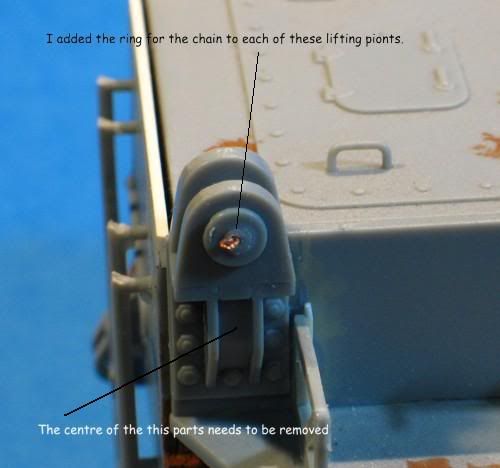

-rings and chain need to be added to all lifting toggles as well as bolt detail to the back

you will also need to add pins with chains in the centre here on both sides. I also scratched the mounts for the railings as the kit ones were too basic and small.
The ladders at the rear are also too thick and short with the wrong shape to the curl at the top. Locking pins need to be added to the holes at the base at both ends near the wheels.
