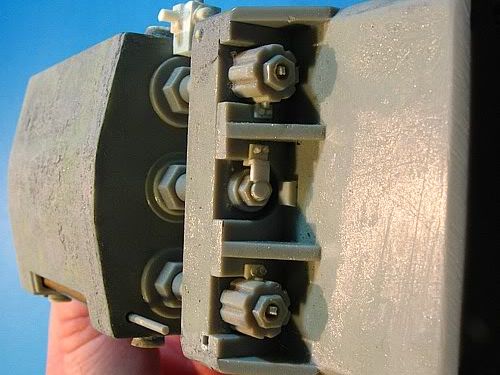

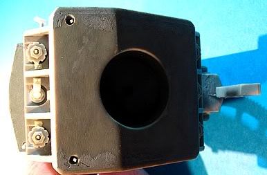

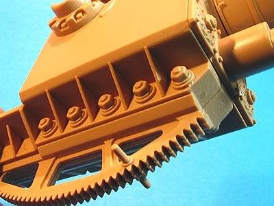

Some more shots of the gun mantlet area.
DML IS IN THE LIGHT GREY.
TRUMPETER IS IN SAND.

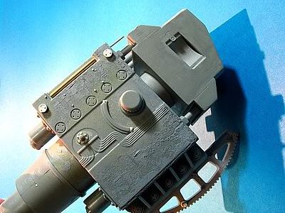

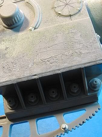

I added heaps of texture to simulate the rough sand casting that these things had. Close up shots show this surface to be REALLY rough.
Both kits are as smooth as a baby's bum so I gave the plastic some texture with some Testors liquid cement and a brush that I have cut down to a short stump for just this purpose.
After a couple of coats of this with stippling the plastic in between, I add some Mr Surfacer 500. I stipple this as well, with two coats, then gave it a light sanding to take off the high spots. If it needs a little more I then use the 1000.
I had to add a brass rod to the bottom of the DML were as the trump. had it already. Also take note of the shape of the large nuts between the kits

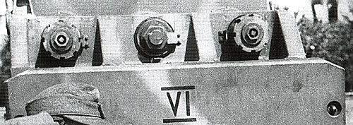

I would have given the DML mantlet another sanding though if I had gone ahead with it. You can see quite clearly the extremely ruff cast to the mantlet in the cropped shot from allied and axis.Some other shots I have seen show the top and sides of some of the other gun mantlets and the textures were all different but all very ruff.
Another crop shot[right] shows the nuts etc that needed to be added - I just wish my P&D was up to it as it seems to punch them out with weird tops more often than not.

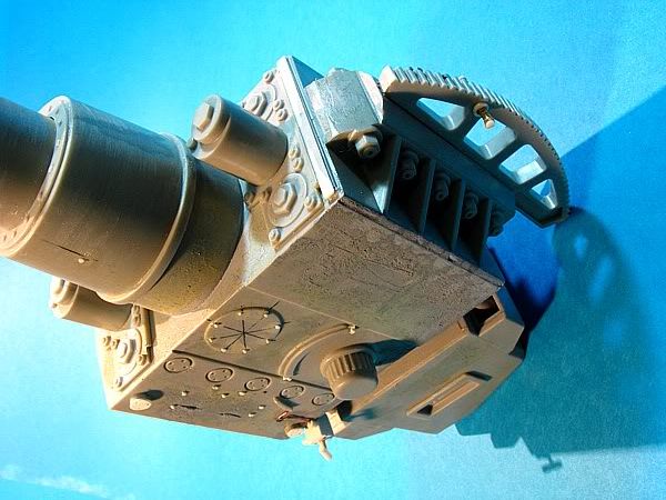

The trumpeter mantlet also gives you the option of building it without the top section- as they used to remove this for rail travel when tunnels were on the route.
This section would be fairly greasy withe the centre exposed [i think] so that is how I ended up potraying it as you will see as we progress.
Texture before a light sanding.
The base for the breech is better shaped as well.
The two two breech block's side by side..............
A world of difference in detail and accuracy.
