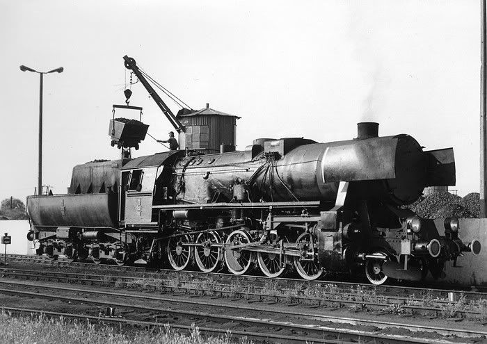

Reference Shots
A friend at work found some original BR 52 photos in his spare room. They turned up in a bunch of old photo's he bought at an auction some years back. He has allowed me to scan them and put them up here.
This first shot is from Germany in the 1970's but the coal is being loaded in pretty much the same way as the 40's I think. It looks untouched except for the lights at the front. It is running the later Tender.
