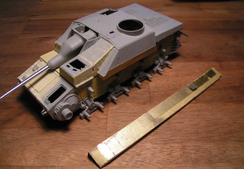

The lower hull is complete besides a few minor details that will be added later. The zimmerit coat is also complete besides the area around the left side brake access hatch. Some zimmerit has been added to the upper hull (some was removed again, as can be seen above the drivers hatch). The upper hull, gun and roof is just dryfitted. I prefare to keep the larger parts seperated for easier application of the zimmerit. The first of the fenders is right beside the model. It is easy to assemble, but the fit to the hull........ more on that later.
A better view of the left side of the model. As can be seen the coat of Zimmerit is quite uneven

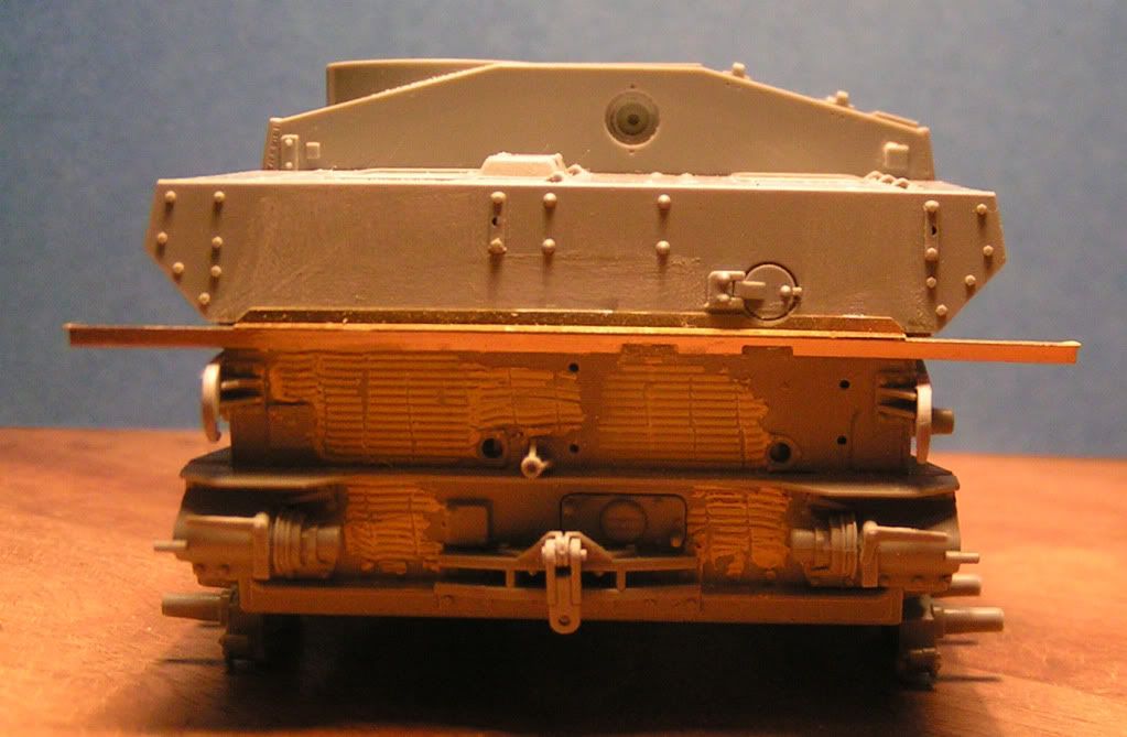

The rear of the model. this is where I made the first major mistake. I choose the wrong base for the idler wheels. Dragons instructions shows both the wrong and the right choise, and I simply overlooked the right one....... Nothing to do about it now.

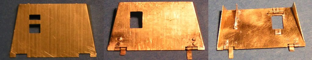

I have been working on the MG shield. With the parts from Lion Roar, Orange Hobby and Dragon, I more or less had two choises. The Orange Hobby and Dragon shields are allmost identical, excetp for the fact that Orange hobby, for what ever reason, choosed to make two openings in the shield instead of just one, as can be seen in the picture below. The shield from Lion Roar has a different shaped opening, and as far as my references can tell, this more of the earlier style intented for the MG34. Dragon And Orange Hobbys shields are for the MG42.
Though I am building the early Stug IV, I want the MG42 so I went along with the Orange Hobby shield, also because the Lion Roar shield is close to 1 mm taller that the other two.
Below are pictures of the shield, both front and rear. I cut off the small strip between the two openings to get the right look of the shield. I also exchanged the lower half of the hinges with some strip of etch, mostly beacuse those from orange Hobby are to short to bend proberly.
