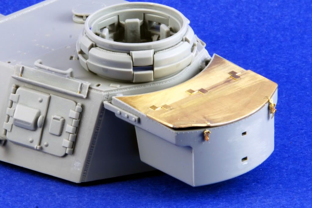

still can't bring myself to sand all those wheels so i skipped around a bit. i did finish up the shurtzen plates on the other side however so the only thing i need to do to get it on the tracks is clean up the wheels. hull still needs the cables put on and the extra track armor then it's pretty much done. but again, putting that off...... so instead of that i started work on the turret bits. there really isn't much to the turret now that i really started looking at it. i put on some of the larger parts to get started and then went to work on the bin. the kit one is pretty nice with two exceptions. first, the hinges are just plastic blocks which is not the greatest in terms of appearance and then second and more importantly to my eye, the front portion of the bin top should be flush with the top of the bin as it is rivetted on from the sides as shown.
the kit part mounts on top and sticks up pretty far so the pe was worth doing in my opinion even if not all that noticeable of a difference. since it's pe, couldn't help but bent it up just a touch and break the latch on one side
i went with the kit brackets to attach the bin instead of the pe for one very important reason. i'm terrified of the shurtzen not lining up correctly and i couldn't take the chance that i might put the bin to close or to far away from the turret. at least this way i know that i've got a perfect foundation for them so if there is somthing wrong, it's in the schurzen, not somewhere else. they are slightly oversized but within reasonable tolerances so i'm good with it.

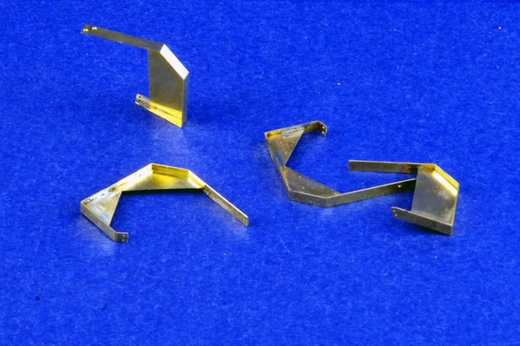

once i had the bin taken care of, i decided to start work on the dreaded turret shurtzen. first step was the bracketry which must be as close to perfect as possible if i'm to have any hope of these things fitting correctly. fortunately, they are pretty well made and easy to assemble. the parts have grooves for the plates to sit in so you can't really mess this part up. all the parts are soldered together for strength and i only had to solder a couple spots on each bracket to sure them up. again, well made and went together without a hitch.
it's worth noting that these are not the brackets that come with the griffon set since it's really made for a later H. i had to buy this update set separately to get the correct early style brackets. it's a shame because now i have a full set of late brackets and shurtzen that i won't use...... the additional set is also made by griffon model.

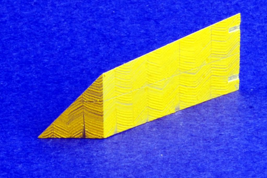

next up was the zimmerit. i decided it would be best to apply this before i bent and attached any of this. this patters is hard to do unless the surface is lying flat so i stuck the parts down on some two sided tape and just went down the line.
the next part will be the test to see if after i've soldered the plates onto the brackets, i can get any of it to line up properly. as always, look forward to your comments and critiques. please let me know if you see any inaccuracies so i can correct

Posts: 605
i soldered the brackets to the plates so not sure i could have done it that way...... anwya, i've managed it after much effort. thought it would be much easier to zimmerit a flat surface instead of after attaching them first. i experimented with the zig zag zimmerit pattern and just couldn't get it to do right unless i could really steady my hand and do it on a flat surface and i didn't want to have to press on the plates once glued into place for fear of breaking the parts loose or tearing up the hinges. think this was the right approach in my case but it would have been a pretty difficult job any way you go about it i think.
