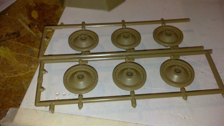

For the 8 missing inside road wheels that the Tamiya kit is missing, I'm attempting to cast my own. I've done a little resin casting in the past, but never using a plaster mold. If this doesnt work I'll get some RTV and redo it, but I thought for a little work I'd give it a shot, and I had the plaster on hand.

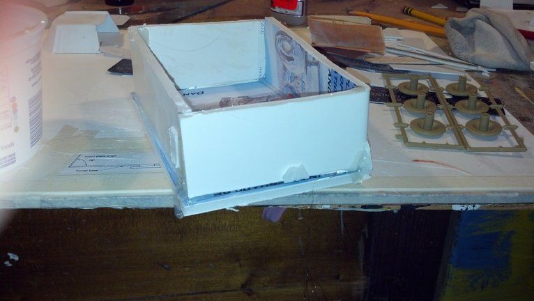

I made a rough box out of foam board and hot glue:
I left the road wheels on the sprues, but I bunched 6 of them together and glued the sprues together to make it more compact. I need 8, but I figure I'll make 3-5 castings anyway.
I then poured the plaster into the mold, and since my mix was somewhat stiff, I was able to press the pieces into the plaster. We'll see what happens!
